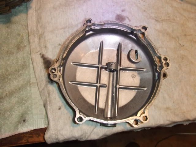

If you're not familiar with EFM auto clutches, they add a custom pressure plate that has a ring of ball bearings that operate centrifugally. It's a nifty system, but it adds about 1/3" to the height of the clutch assembly. As a result, you have to add a spacer so the clutch cover clears the EFM pressure plate. Here's the major snag in my plan. The H series clutch cover is larger with a different hole pattern. The H series spacer definitely won't work.
Plus, the H inner clutch cover must be a little deeper than the E also, because even with the H spacer resting on my inner cover, the outer cover won't reach. I'll need a bigger, E-specific spacer to make this work.
There is no way to make the original clutch pushrod mechanism work with the EFM, so I may remove the clutch actuator shaft needle bearing and its seating area on my clutch cover to get it to sit further over the EFM.
It's that needle bearing area that bottoms out on the EFM pressure plate. Even with that area relieved, I'll probably need a bigger spacer to get everything to clear.
I'm encouraged. I think it'll work as long as I can get an adequate spacer for the clutch cover. I'll have to call Garry at EFM and find out how thick the usual E series spacer is. I may just be able to use that off-the-shelf part instead of having one made.
