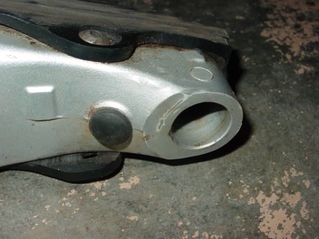

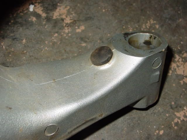

Unfortunately for me, the area right behind where the bearings are pressed in is hollow. In the two pictures, you can see the black rubber plugs that keep dirt out of the hollow cavity behind the bearings. From what I can tell, if I tried to cut the swingarm, I'd cut through the aluminum and expose that cavity. Plus, the yz swingarm uses two sets of bearings on each side. So there isn't that much dead space like there is on a kx.
I was really hoping I could use my yz. But I'm now thinking about trying to find a kx and then selling my yz when I'm all finished with the hybrid.

You might take one more look at that YZ frame.
What has to happen is that the CS sprocket on the motor falls in line with the rear wheel. You can't do anything to the outside of the swingarm 'cause it still has to fit the frame.
On my CR/KDX hybrid I had to shorten the case, enlarge the hole in the case, and shorten one of the inner bearing races. I've been riding it hard for over a year with no problem.
I'd set the motor on the bench, set the swingarm up with the bearings and inner races installed, and see what has to go where.
Like you said, you don't care where any of the other mounts are. You are obligated to mount the motor to the swingarm first so that the CS sprocket is in the right place

Ted-
I think I had to take about a 1/4" off the case on the right hand side. I had to shorten the inner race of the swingarm bearing on that side 1/8".
You can tell from the parts diagrams what is going in the case halves. All was well on the left (CS) side.
This is on a '99 CR250
I had to drill out the swingarm bolt hole. From 14 mm to 17mm? It doesn't matter. There was still some of the steel inserts left. I tried to push them out at first but it was not going to happen.
I'll tell you how I cut the case if you promise not to tell anyone....Die grinder and a 3" cut off wheel
I scribed a line at less than 1/4" and cut by hand as straight as I could. I did not split the cases but the cylinder was off.
Then I mounted the motor in a drill press and used a big end mill I borrowed from work to try to flatten out the cut.
The cut ended up a bit crooked so the inner race on the right side does not sit quite square against the case.
Seems to be O.K., Ive been riding it for over a year, ran it in 4 Enduros, absolutely nothing has gone wrong on it.
No one can tell from here what you've got to do to get the YZ swingarm and KDX motor together. You'll need to have that KDX motor on the bench with the YZ swingarm and work it out.

The plugs aren't a problem, it is what the plugs are plugging up. There is a hollow cavity behind the area of the plug. If I cut the swingarm, I'll open up that cavity and weaken the swingarm.
I bought an extra swingarm on eBay and I'm going to mock things up and cut the swingarm to see what I'm dealing with.

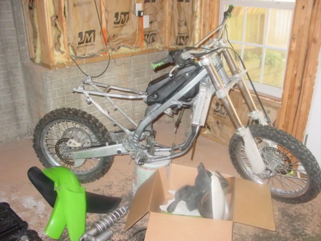

Thanks for the insight and advice on narrowing the cases.
I decided not to use the YZ afterall. There are a number of unknowns with using that bike and it is in such great shape that I don't want to make it un-sellable if things don't work out.
So I picked up this '04 KX 125 roller a couple of nights ago and already started working on the swing arm. I'm using a table saw to cut the swing arm and will post those pictures in a different thread.
[/img]
