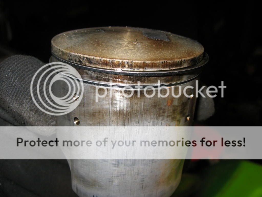

Piston intake side

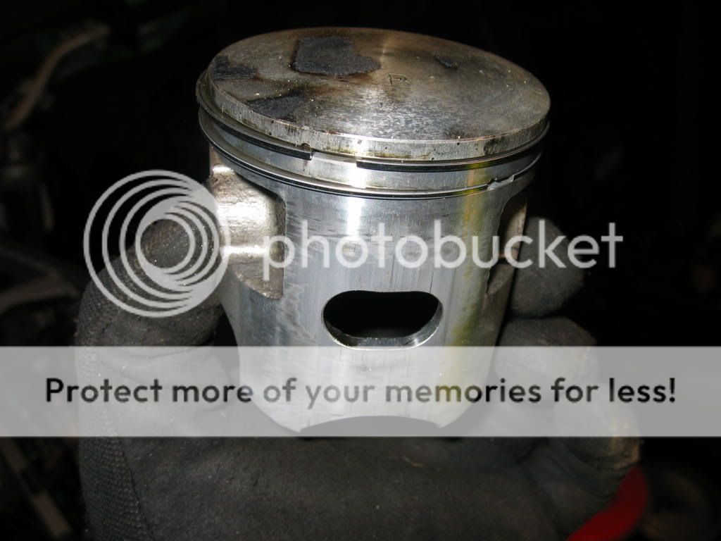

Piston exhaust side... blow by

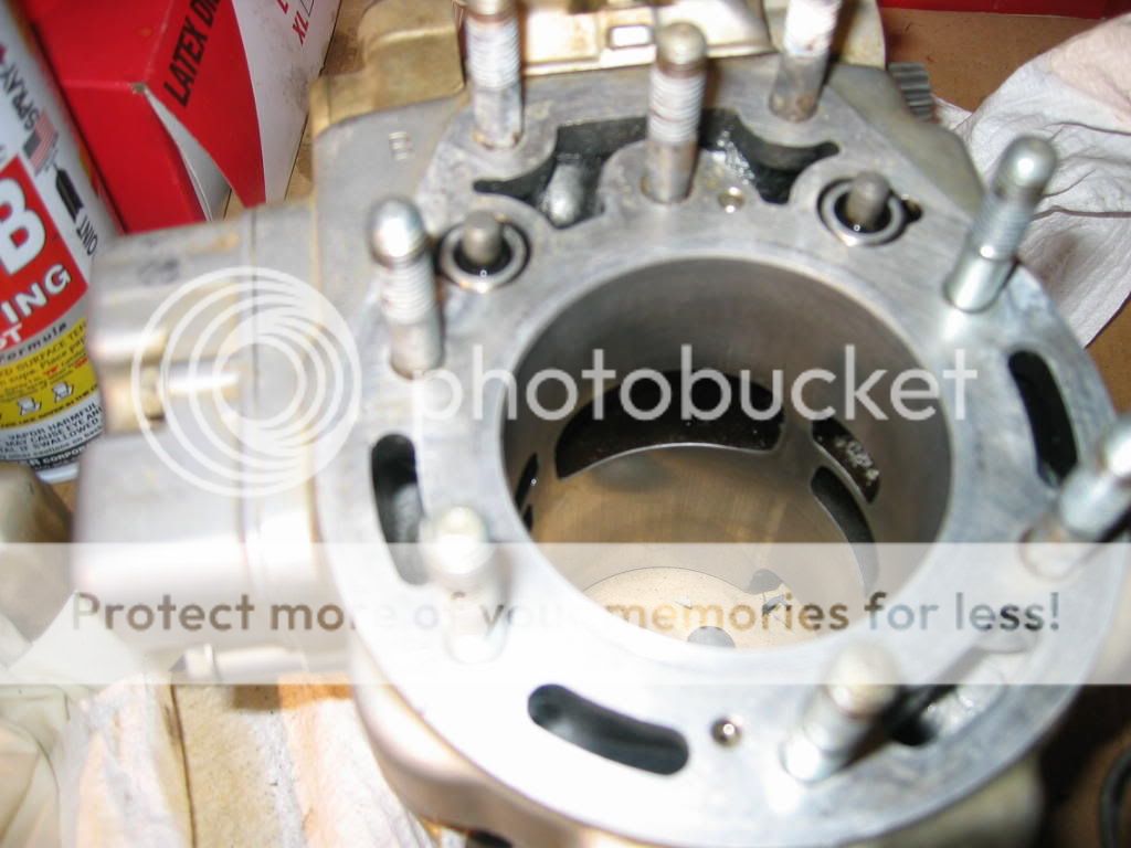

Cylinder shots
Piston skirt measurement was at service limit. Time for a new piston.
Ring end gap, and second ring width and clearance within limits.
Not too bad. I can still steel the cross hatch. There are some vertical marks but they are not scratches or gouges.

Piston intake side
Cylinder shots

That engine has been eating some dirt. That piston is scratched pretty good. I'm suprized the cylinder looks as good as it does. It's definately time for a new top end.
Wet a scotchbrite with WD40 and run it around in the cylinder then wipe it clean.

dirt: I agree. There was grit under the head. I thought that was strange. I would expect that area to be clean. I'm anal about my air filter. I keep it clean and oiled. What's even more puzzling is I don't ride in sanding conditions. Almost always rocks and mud. Maybe the PO of the bike wasn't so attentive. Any where else dirt could get in?

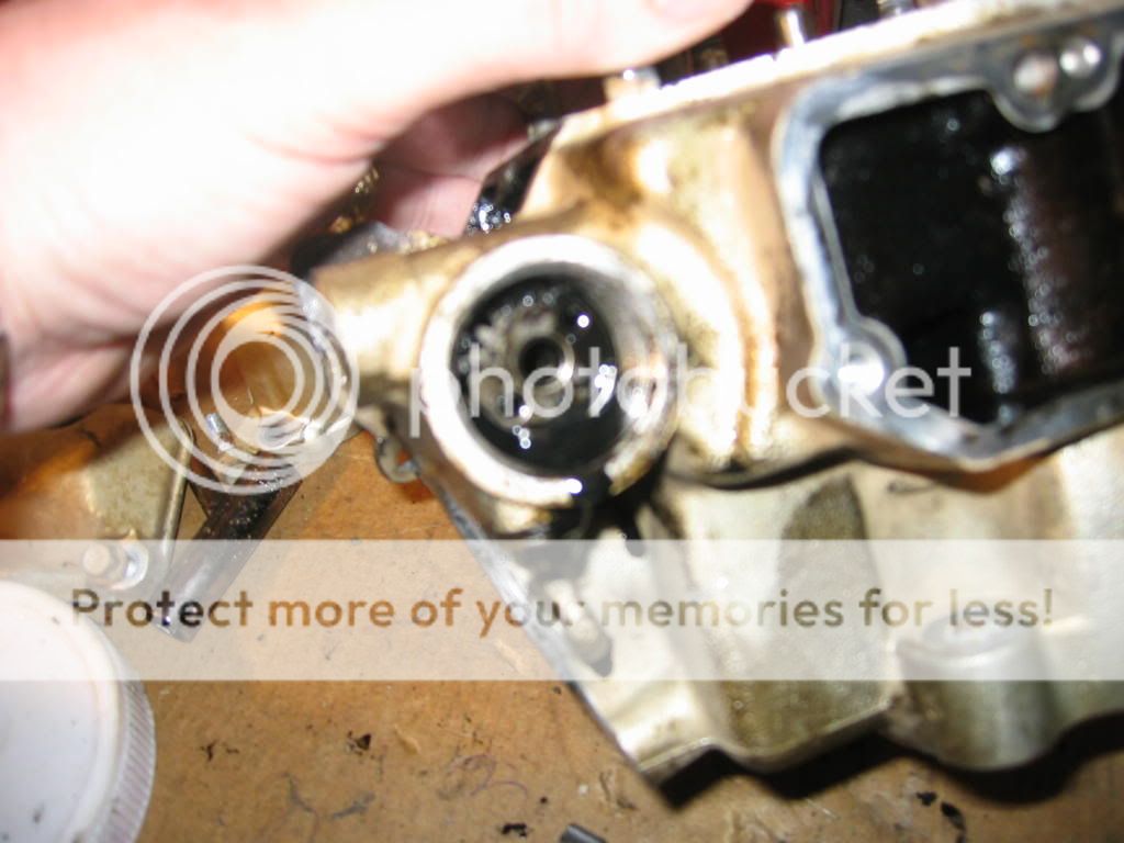

How did you get the main valve out? I've followed all the steps and it wont come out. Could carbon build up stop it from sliding out?
This step is confusing me:
"Remove the left pinion on the main shaft and pull out the main shaft"
I was able to remove the main shaft... the pinion is on it. Not sure what they meant.
Do I need to remove the valve lockbolt and gear to get the main valve out?
Also, the manual shows a spring on the valve lockbolt. Mine didn't have one but it did have an extra washer ???

Got it apart. The carbon build up prevented the main valve from coming out. Scrubbed some cleaner and pulled it out. That valve has an 1/8" of hard carbon on there.
Nothing broken in the KIPS. I hope I can get it back together.
Also, the spring was missing under the valve lock bolt. I checked inside the cylinder and it wasn't there. I took it out slowly so I know I didn't lose it.
There were two washers on there instead of one. I thought I read somewhere that removing the spring was a mod to get the hit to midrange to come earlier. Any truth to that? Should I put a new spring back in?
