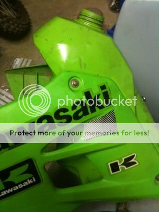

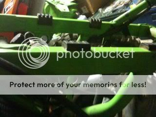

i also have issues with the tank mounts onto frame...
Yes - I have check fiche and cannot see any hardware to mount the tank onto the frame as per photos shown.
I see an internal thread each side of fuel tank.
To match these holes, I see mounting holes in the frame that co-incide with these threaded holes in the fuel tank...
What is used to mount this tank to the frame?
Maybe I am missing something - maybe those frame holes are not used to mount the tank? ATM they are not used for anything...

More missing parts.
There should be rubber grommets with aluminum sleeves inside them in those large holes in the brackets on the frame in your last picture.
I think you'll notice those large holes line up with the threaded inserts in your tank.

Thanks Karl.KarlP wrote:More missing parts.
more hardware to order.....
