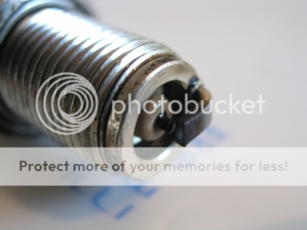

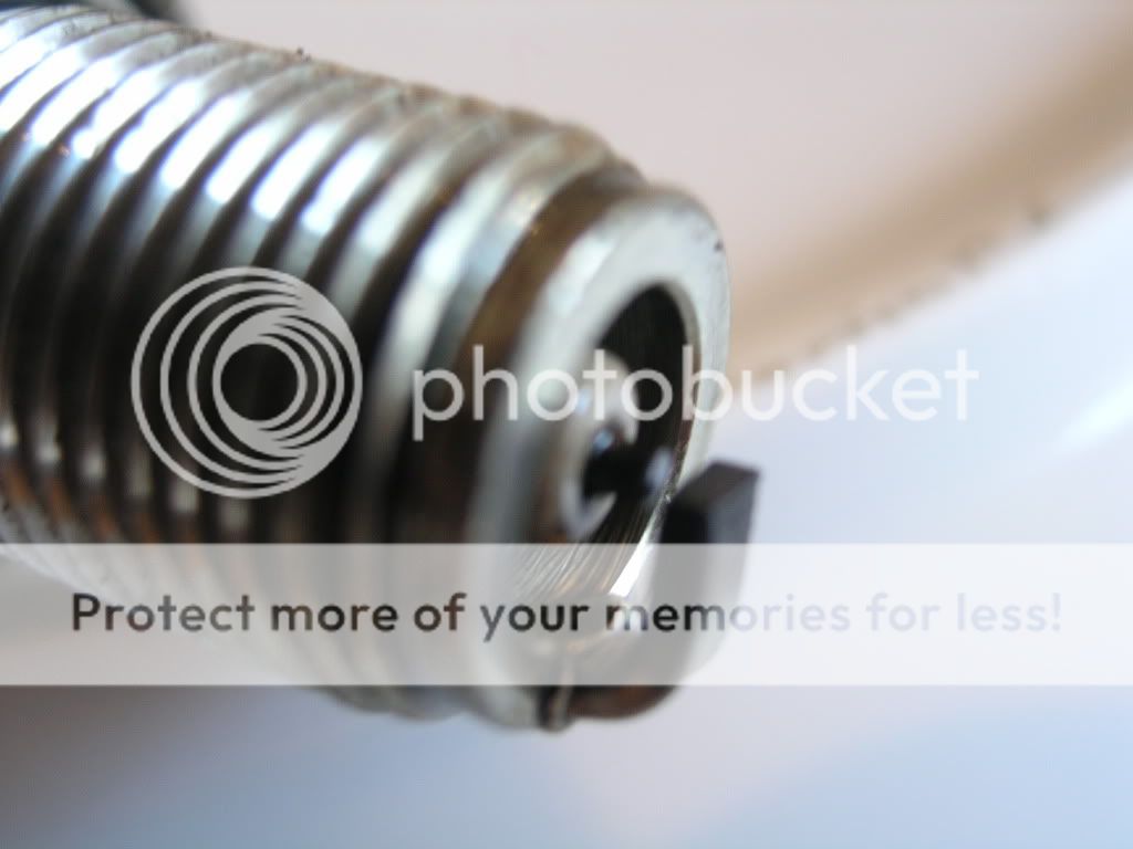

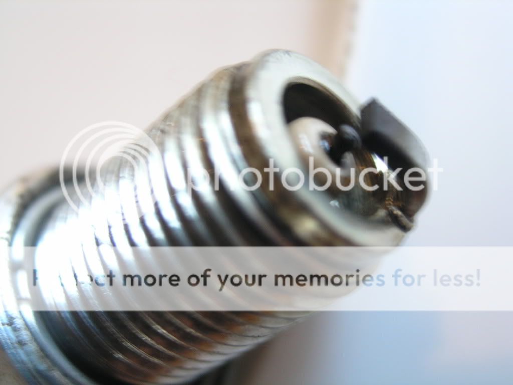

- Posts: 235
- Joined: 04:47 pm Mar 19 2009
Plug is new (no more than 500m) and is NGK BR9EG.
No being an expert on these things, but form these photos, it seems I have not fouled the plug.
I am willing to stand corrected however...
SOrry for poor quality of photos - still leanring MACRO on the camera...
I did not rev it before OFF.
SHould I do this from now on? Purpose of this activity?
No being an expert on these things, but from these photos, it seems I have not fouled the plug.
Have I fouled the plug?
I have dumped all new fuel from tank and willign to start again...
Should I use 50:1 fuel mixture instead of 40:1?
THoughts?
Byte
- Indawoods
- Creator and Founder
- Posts: 9951
- Location: Midwest
Put a BR8ES in it and be done with it.
Why are you putting a 9 in it? That's a cold plug.
You really need to follow the MANUAL!

- Tedh98
- Posts: 1576
- Location: Atlanta, Georgia
I'll try on this one . . .
Your plug looks wet with fuel. Remove the plug, kick the engine over a few times and put a new plug in or dry that one. Then without giving it any gas, try starting it up again.
I had an old kx250 that had a plug that would look like yours. The problem was the float level was set wrong. Once I set it properly, I never had starting problems.
