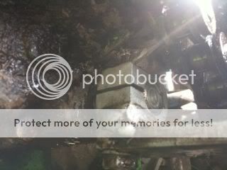

Thanks Canyncrv -
here is some clairification...
I too the bike out into sunlight and observed no free play betwen the lever and the shaft - sorry for misleading everyone here.
But, I guess that freeplay i was referring to was the amount of slack to take up before a gear was selected. Maybe this is normal...? THoughts on this one?
Here are some lovely pics...
Maybe I am pissing up a tree here but just want to make sure of this slack/free play I observe...
Byte
Byte
- canyncarvr
- Posts: 6943
- Joined: 01:07 pm Nov 05 2004
- Location: The Mythical State of Jefferson
..and still it didn't happen.
While you may well be pissing up a tree..one thing you certainly have not done is..
Get yourself a permanent marker..a Sharpie (not something that will leave a 5mm wide mark). Draw a diameter across the shift lever/shift shaft. Move the shift lever up and down while watching that mark.
We've gone down a long primrose path on this..all started from the stated 'fact' that started MARCH 20! Now..after merely looking at it in the light (another old thread/question had to do with maybe using some LIGHT, 'eh?) you proclaim it does not move.
There isn't any particular reason I can come up with to give the MARCH 20 'fact' ('it's loose!!') any more or less credence than todays '..observed no free play'.
The lever can be loose..and you CAN'T SEE IT just wiggling it around. It can be tight and LOOK loose...just wiggling it around.
THAT is the point of marking it..observing that mark during movement..and WATCHING FOR A SHIFT OF THE MARK AT THE LEVER/SHAFT JOINT!

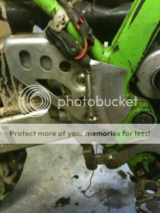

Part of a brake light switch system?Byte wrote:I have a query relating to this photo.
This setup came with the bike I purchased 1 year ago.
What is this spring and why is it used?
What is the spring connected to?
Did the previous user improvise on something?
Byte

Obviously the shaft HAS to be moved to select a gear. It's not a digital button that you can touch to shift, it has to be moved up or down to select the proper gear. if you can grab the shaft with the lever removed and it has play up and down or side to side then the collar that goes around that shaft is probably worn a bit. If not then it is probably fine and working as it should.Byte wrote:Thansk Canyncrv.
I performed the sharpie exercise and do not see any line break between shaft and lever.
I observe the shaft moves when the lever moves.
Can anyone advise me if they observe slight movement of lever(and shaft at same time) before a gear is selected?
Byte
And yes, that looks like someone's home brewed version of a brake light
switch.
Random piece of advise: It's always nicer to work on a clean bike. Take some soap and a hose to that thing before you start wrenching!

Juliend - YEs, I acutally removed the lever for 'kicks' (pardon the pun) and checked for play on the shaft - she's tight as a virgin
Re: brake light switch (homebrewed version) - what have other's done to achieve the same effect but neater and more solid onf the kdx?
I guess the previous owner needed this mod to achieve registration perhaps?
Byte
