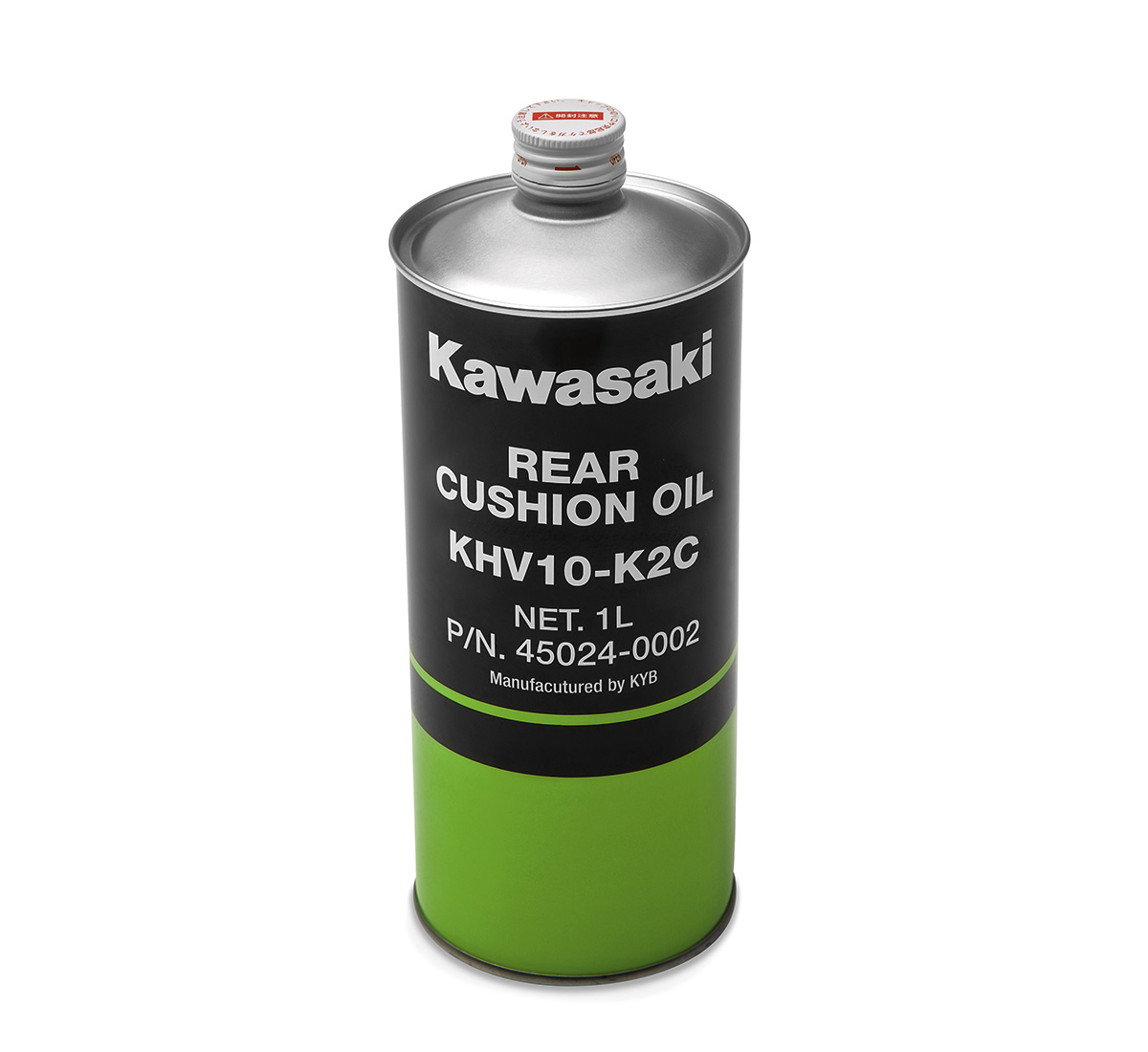

As stated lots of videos on rebuilding they kyb shock, I would say the only thing that's not covered in enough detail is oil type and viscosity, worth learning about before choosing

I encourage everyone to watch the Race Tech videos on youtube. Though it is for a 1993 Honda, it also mentions KYB areas.
For oil, no need to overthink it. Use KYB oil, as it came when new.
https://www.kawasaki.com/accessories/it ... Source=120
