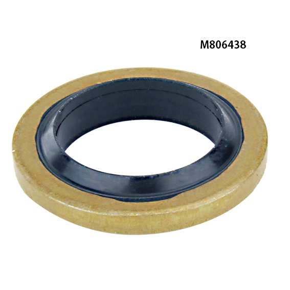

John Deere M 806438 are 12mm rubber sealing washers which work great.
They only require a light tightening due to the rubber seal.
Far cheaper " a few bucks " locally , than some of the ridiculous prices on line.
https://s3.amazonaws.com/cdn.hartvillet ... _thumb.png
Otherwise : plenty of " aluminum " 12mm sealing washers can be found on line.

C George wrote:John Deere M 806438 are 12mm rubber sealing washers which work great.
Never would have thought of that one.

G22inSC wrote:C George wrote:John Deere M 806438 are 12mm rubber sealing washers which work great.
I actually stand corrected ,,, the drain plug is 10mm , not the 12 as stated.
Surprised you guys didn't correct me :)
