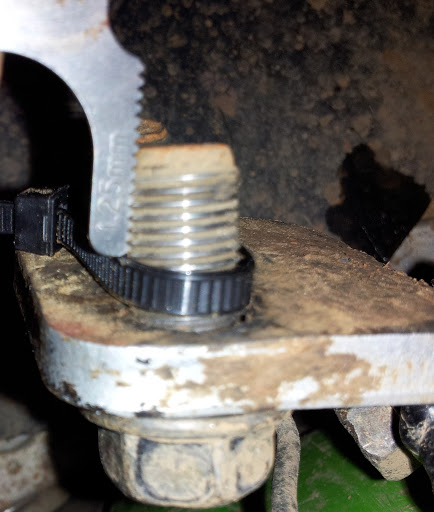

I want to fit a stand to the swingarm, anybody know the thread size and pitch for the bolts?

kx200 wrote:Part number is 130G1035 it is a 10mmx35mm flange bolt that is all the fiche show. pitch size is 1.25 or 1.0
The fiche is incorrect. Its way bigger than a 10mm. My guess is 12 x 1.25 but wanted to confirm. 10mm slides right through.
Will go buy some bolts today to confirm or be wrong.

12 mm x 25 mm but the pitch is not common because I tried with a basic M12 bolt but it doesn't fit. $3.18 each on partzilla.

bolt diameter = 12mm
bolt pitch 1.25
if it's hard to find that size bolt, drill and tap to the most common sized metric or standard bolt you can get at every parts store- that way, if you ever need it... ;-)

Yerp confirmed. M12 x 1.25. Have bought some and just tried em. Perfect fit.
