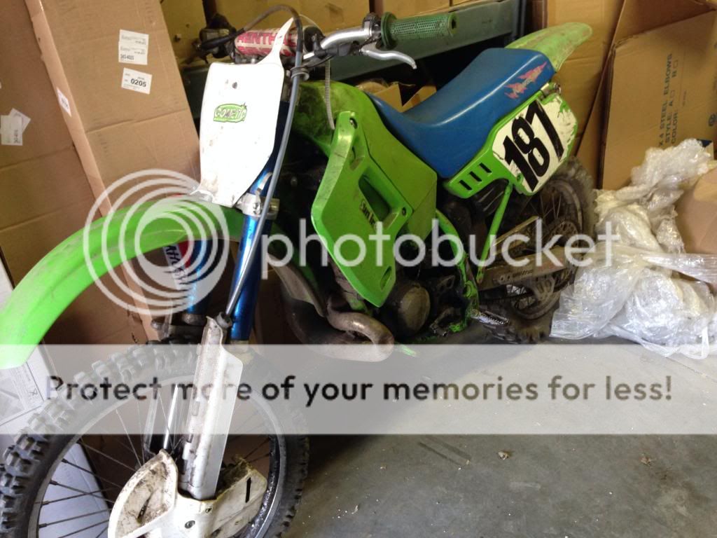

Just picked up a 1994 KDX 200 that has been sitting for a few years now. I'm new to 2 strokes this is my first. The previous owner purchased the bike and did not put very much time on it before it died on him. He was practicing 1st gear wheelies and was topping it out rpm wise. He did not think it overheated but maybe ran out of gas. Tried starting it again and it ran momentarily before dying again. Was worried about something major being wrong and put the bike up. It was not low on fuel. Was running a 50:1 ratio.
Now here it sits.
I'm not to sure where to start with it. Compression test? Carb clean? Spray of ether to see it fire?
I've read through the newb page which is extremely helpful but seems to be a thread for a running bike. I just need a starting point, so maybe I can get your thoughts on where you'd start. I'd like to get it up and going for the season, without tearing it all apart if I don't absolutely have to.
I don't know when the last time the piston rings or top end has been replaced if ever so I guess I'm confused as to how you know when to replace them and which parts to replace.
Hope this makes sense. Thanks for any replies
Now here it sits.

Don't look bad!
Worth some effort to check it out.

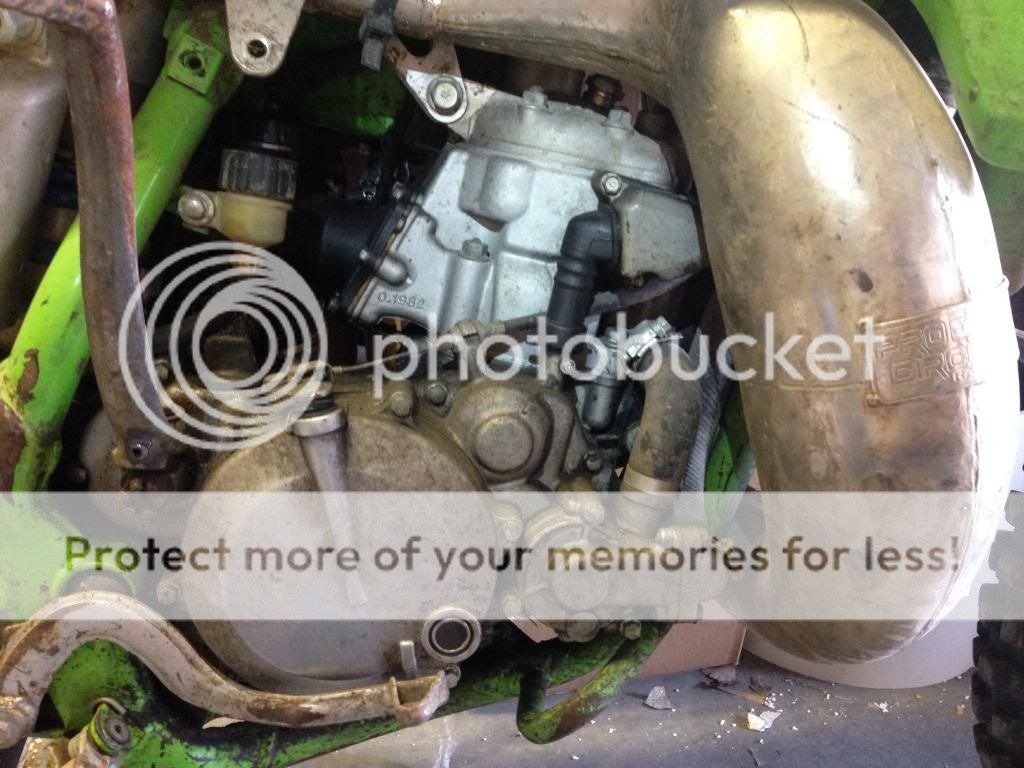

Looks like the Jug was cleaned/service lately, did he say anything about having a top end done?

Looks like a nice find.
One question what is going on with the expansion pipe? If you look at the pictures by the bracket and hole is there a piece missing or is that perhaps the wrong pipe? How does it look bolted to the rest? I don't think that ziptie will last on a long ride.

It's missing the dampening mount, nice catch!ICRage42 wrote:Looks like a nice find.

My FMF gold pipe doesn't fit my bike either and that mount had to be skipped as well because it didn't line up...
These are just 2 random KDX's for example. I think there was at one a revision on the E frame. Have a look at these two pictures and compare the "V" that the frame an the subframe make. Unless the second picture just has some sort of plastic cover but I think some changes were made to the frame within the 89-94 time frame...

Second one has frame guards, probably made by Acerbis (mine look just like that).

New plug, check for spark. If it does, give it a shot of ether and see if it fires. As far as getting it up for the season without tearing it all apart, a little unrealistic for a 2 stroke that has been abused and left sitting for a few years. Assuming that the compression is good and it fires a short list of what I can see is:
That is the absolute minimum I would do to get through a full season. Properly maintained these bikes are a breeze to keep going, neglected they take a bit more work to bring back.
- new levers
- new lower brake hose guide
- a thorough cleaning
- the rear axle has been installed from the wrong side (the clam adjusters are upside down)
- rear brake reservoir looks a little low (new fluids are in order all around anyways)
- a thorough carb cleaning and run through the jetting procedure
- check of wheel, steering and suspension bearings
- at least one seat bolt appears to be missing
- pretty healthy ding in the header portion of the pipe
- Odo drive cable missing, you'll want to make sure that drive assembly is plugged/capped

Will this dampening mount fill the space between the frame and pipe because they don't seem to even come close to lining up.6 Riders wrote: It's missing the dampening mount, nice catch!

those dampers never last long and will fill the space you mentioned
here is how I handled mine
http://www.kdxrider.net/forums/viewtopi ... 77&t=14503
