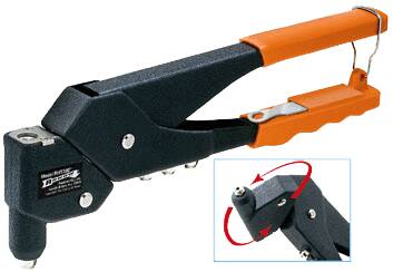

or you could get a rivet toolkdx220freak wrote: I think you guys are saying drill out the rivets right? then go get some self threading screws to replace rivets?
They are really simple to replace
