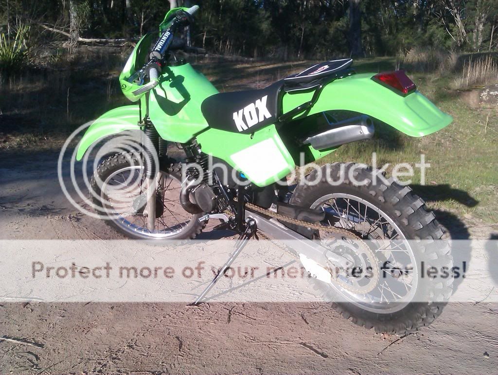

I have been riding VINDURO (pre 85 vintage enduro) for a little while now. Early this year I purchased an 84 KDX200 and just finished restoration. Remembering the 175s from way back in the day I went searching for the little KDX200 two banger to give me a better bike option for some of the tighter Vinduros than my current Yamaha TT600 4 stroke. First rides on the Kawasaki have left me really impressed by this little green gem. Although it was not quite ready and has missed out at the two last events that the tracks would have been well suited, I cant wait to try it out at the next event we have coming up.

Very nice job on the bike!
- Posts: 14062
Re: Vintage Enduro
Daaaaaaaang. That is nice. Congratulations.

The bike looks great. Make sure you post up after your first enduro. I bet you'll love that bike.
