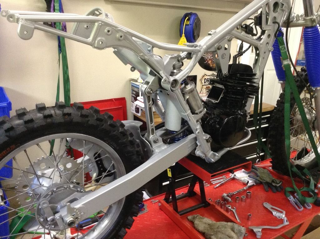

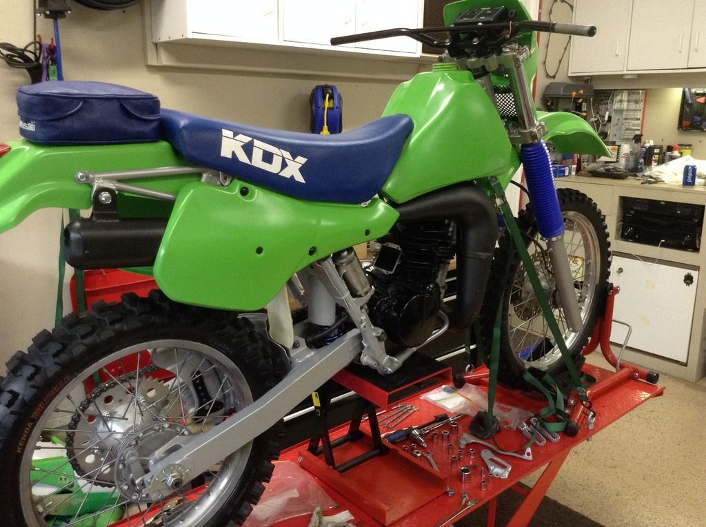

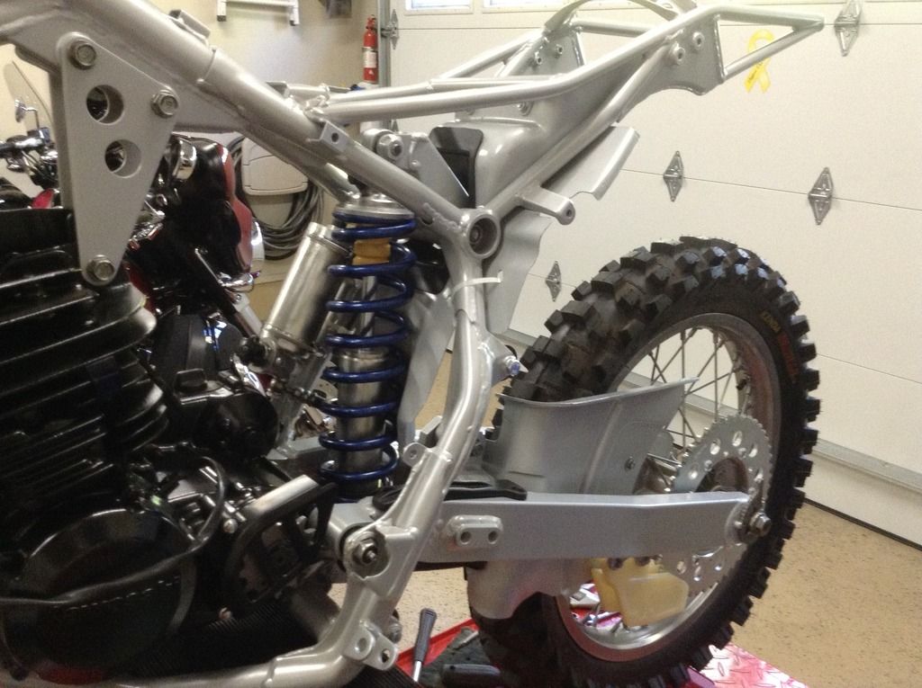

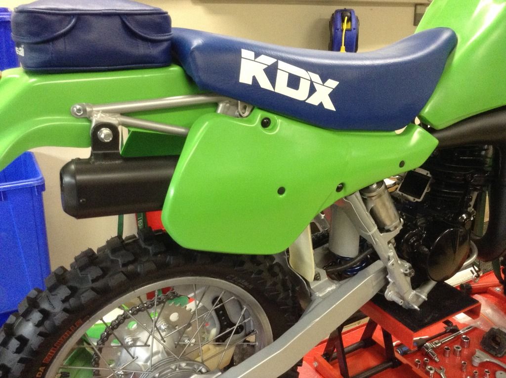

When I was a kid I had a picture of this bike, so now having a chance, I'll Restore one. I'm into Harley's, trail bikes are a whole different story. As most of you know that these years of the '87 some parts are hard to find, especially trying to make it look original. The Air Box is one and then the Kickstand. Enjoy some pictures.

Very nice..!! It will be a shame to use it and get it dirty.
What did you use to refinish the frame and swingarm?

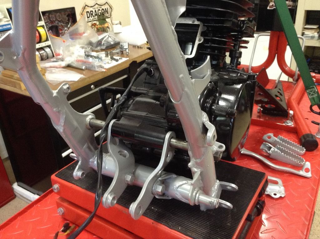

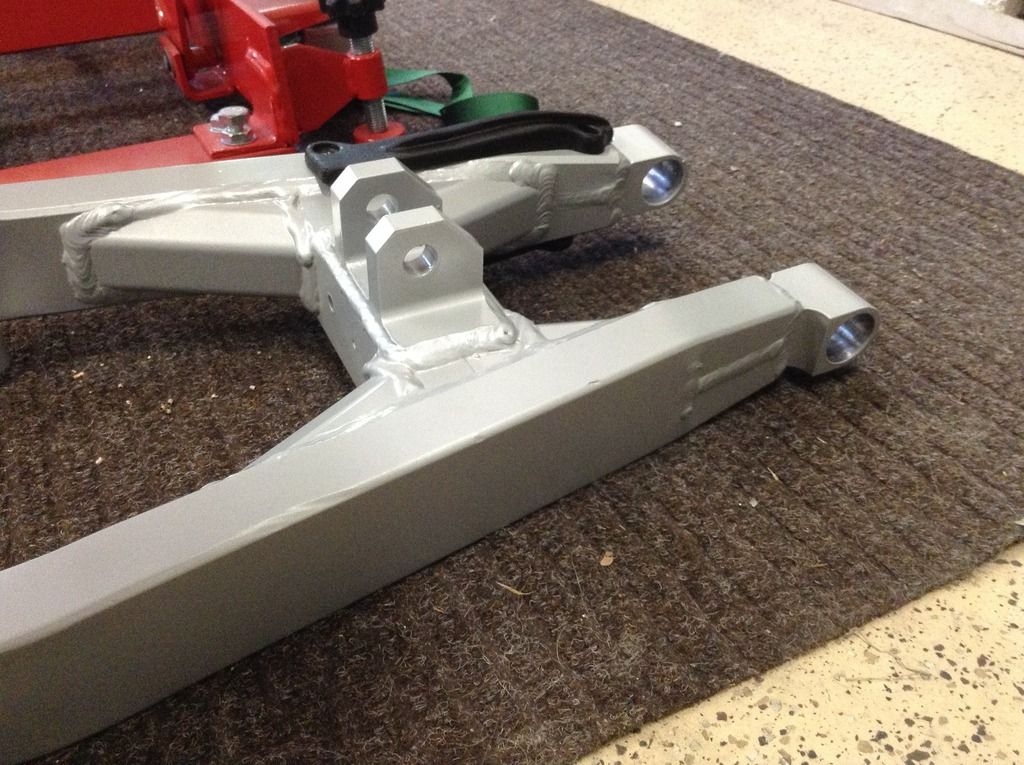

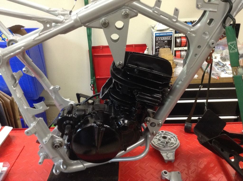

Thanks, I had the frame, swing arm, engine brackets, pegs, upper rear shock link, rear pedal and parts blasted and powder coated. Exhaust was sand blasted and painted high heat paint.
I want the bike to be new again, show it off at the up coming bike show in the restored vintage section and plus it's for sale.

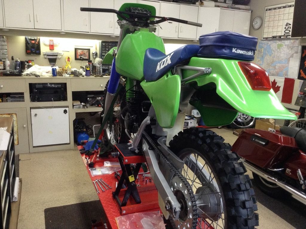

where did you find chain guards for your build? I also have an 87. im looking for the chain plate roller and sliders.

Ebay for reproduction sliders, about $40

I found the swing arm sliders from DC Pladtics, upper and lower roller chain guards on eBay, the chain guide below the swing arm was from eBay. The large plastic guard I also found on eBay, they over time turned yellow, so I sanded and painted grey, same as the mud guard infront of the rear tire for the Unitrack.
