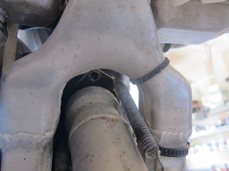

I started out by tearing down the CR.
I was surprised that the CR pipe bolts on, and the KDX pipe is just a pressure fit with the spings.
