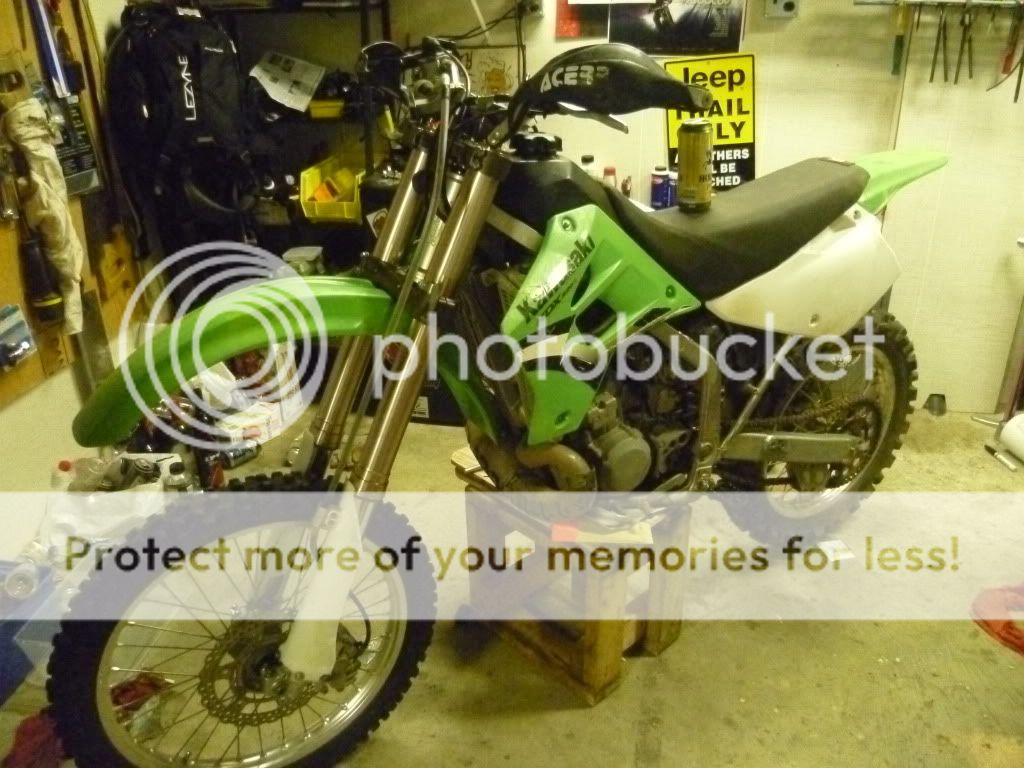

Brought to you by Holsten Premium, I give you...
new forks!
Damn, that was a long project. Between stripped threads, mis installed spacers that had to be removed (from under the lower headset bearing), broken threads, seized forks because i don't know how to install a wheel on an inverted fork, it's been a slice! Time to give them a gentle breaking in tomorrow. I still need to figure out something to stop them from hitting the rads and gas tank before hitting trail. Good times in the basement!

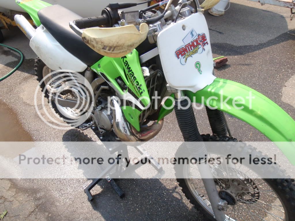

Here she is stock.

I have seen some people have had to bend a piece of thin steel around the frame stop and put a screw thru it to get them to clear things.
Mine felt pretty stiff at first but loosened up after 10-20 miles and seem pretty good now.

I've got a blanket zip tied around the forks for this weekend (probably no or very easy trail for the first ride), but I'm planning a machined piece of metal welded to the frame stop tab.
I'll give the sheet metal strip idea a go too. Thx.

Mine hit the gas tank, I'm not really worried about it at this point

I just put a piece of metal around my steering stop. Works fine :).
